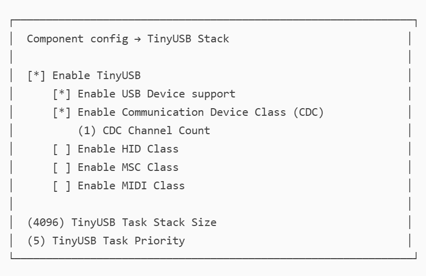

Option 2: With TinyUSB (full USB functionality)
If you need data transfer like a real USB bridge, you must enable the TinyUSB stack.
To do this:
Add the component:
idf.py add-dependency esp_tinyusb~2.0.0
Afterwards, the following options will appear in menuconfig:
Component config → TinyUSB Stack
[*] Enable TinyUSB
[*] Enable CDC class
This sets:
CONFIG_TINYUSB_ENABLED=y
CONFIG_TINYUSB_CDC_ENABLED=y
CONFIG_USB_DEVICE_ENABLED=y
Initialize in the code:
C#include “tinyusb.h”tinyusb_driver_install(&tusb_cfg);Show more lines
This allows you to use your own USB CDC endpoints and send data as you would with a virtual COM port. [docs.espressif.com], [github.com]

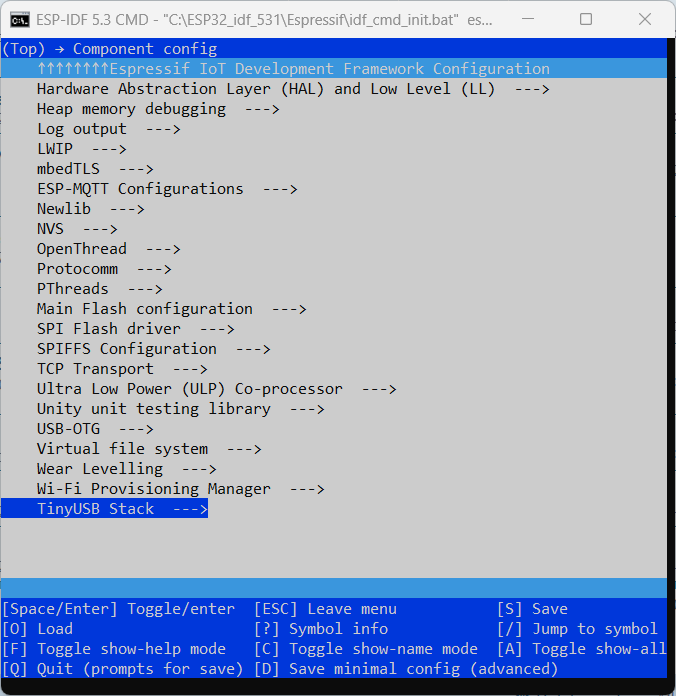

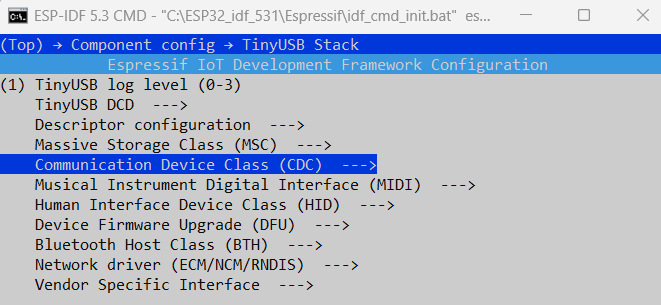

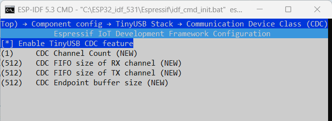

I managed to get the esp32-s3 running with tinyusb!
This is a not very useful demo that opens the USB port - and on my PC this connects as a different port number (COM18 instead of COM5) - and then outputs a string in a loop. Hopefully you can build on this though.
Setup:
I created a Flowchart (I called it tinyusb_test) - and attempt to compile it. Once the directory structure is created - open a command prompt and cd to the program folder (in my case this is d:\projects\flowcode\tinyusb_test - but this will vary depending on filename and whether you use the default batch files)
idf.py add-dependency esp_tinyusb~1.0.0 - to add the tiny usb component.
create main/includes and add the attached .h and .c files - and the directory to main/CMakeLists.txt
idf_component_register(SRCS "esp-project.c"
                    INCLUDE_DIRS "" "includes")
C:\Espressif\frameworks\esp-idf-v5.5\export (adjust to the framework location you are using)
idf.py fullclean
idf.py build - or rebuild from FC
idf.menuconfig - should now be able to edit the tinyusb component properties to enable CDC etc
idf.py -p COM5 -b 921600 flash to flash the program (I use this as it is quicker than compiling from FC - which takes about 20s to set up the environment and I am impatient :-) )
Use device manager com ports (or other) - to check the com port.
Connect with PuTTY at 115200.
Note that to reflash the esp32 - you'll need to reset it...
