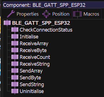

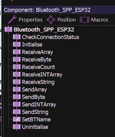

I have a few more suggestions:
A command to set the BLE name at startup as with classic Bluetooth.
Establishing a fixed connection to a BLE using the BLE-MAC address.
Send receive Int_Array would be good to have so that BLE would be compatible with Uart component , Bluetooth classic component and the App developper comport component. Many applications use 16 bits. Probably the other array send/receives are not very important or useful.

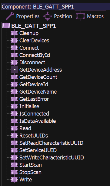

Right this is largely working for me now but it needs more work to make it a bit more user friendly in terms of the usual read/write functions.
First you need the DLL which needs to be extracted and placed here:
C:\Program Files (x86)\Flowcode v11\API.DLL folder.
BLE_SPP_DLL.zip
(101.93 KiB) Downloaded 449 times
Next you need the BLE component. Here is the exported component file that needs to live here:
C:\ProgramData\MatrixTSL\FlowcodeV11\Components
BLE_GATT_SPP.fcpx
(3.05 KiB) Downloaded 454 times
Lastly here is the component source code, it has a little code in the main as a basic test I've been trying out.
BLE GATT SPP.fcpcd
(44.2 KiB) Downloaded 468 times
Let me know how you get on.

Posted: Mon Jan 05, 2026 2:14 pm
by stefan.erni
Hi Ben, Hi Steve
Thank you very much.
BLE also works with the App Developer now. Perfect!
Running a scan and selecting the right module with the address is also perfect.
Sending and receiving in both directions is perfect!
I will also test with the web developer.
I can already work with read and write buffers, but it would be nice if BLE ESP32 and BLE App could read/write in the same style. I mean read/write string, byte, array, int array :) that would be easier for me and others.
Here is an example from the ESP32 SPP.
for comparison:

Posted: Wed Jan 07, 2026 11:31 am
by BenR
Hi Stefan,
Right should all be available for you now via the library updates.
You will need a new version of the DLL for the PC Developer BLE component which now tells you how many bytes are in the receive queue rather then just a true/false.
BLE_SPP_DLL.zip
(113.2 KiB) Downloaded 471 times
