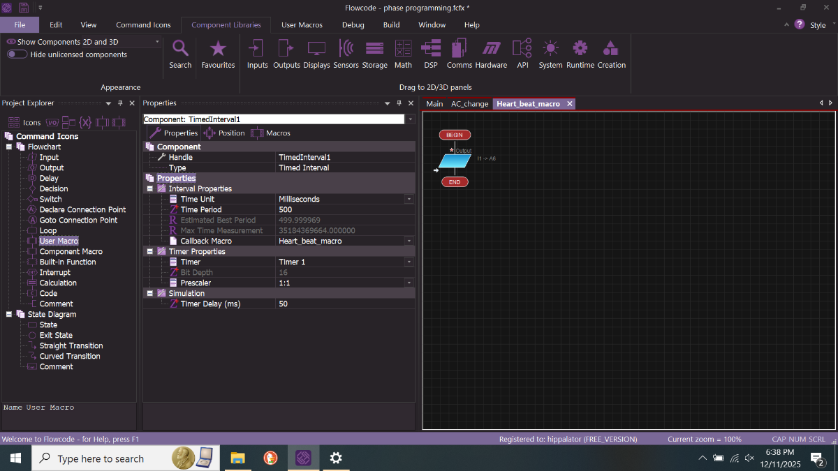

Timers are apparently my kriptonite.
I tried your advice using the Timed Interval component with no avail.
Timer is set to Milliseconds with 500 as the period.
In the user macro I simply added an output to an LED to toggle with a "!1".
The LED turns on and stays on.
Was hoping it would blink every second.
Any clue what I'm doing wrong?
Re: Timer or interupt?
Posted: Thu Dec 11, 2025 10:11 pm
by LeighM
"!1" ?
That won't toggle.
As usual, it's best if you can attach your program file, then we can see what exactly you are doing.

"!1" ?
That won't toggle.
[/quote]
Screenshot (7).png (243.41 KiB) Viewed 4804 times
[quote=LeighM post_id=22219 time=1765491118 user_id=156]
The idea here is to set up a timer to overflow every half second to trigger a user macro that will toggle an LED.

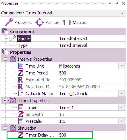

Thank you for the example.
You can have the simulation speed set to either of the fast options and set the Timer interval simulation delay speed to 500 as that is in milliseconds.
Timer Interval simulation delay.png (40.41 KiB) Viewed 4715 times
