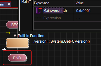

If you mean getting the Flowcode version, then the "GetFCVersion" function provides it. My debug build is showing 0x0B0001 which means v11.0.1 (treat the returned value as 0xAABBCC where the version is AA.BB.CC).
Screenshot 2025-12-04 091038.png (19.58 KiB) Viewed 5102 times
For a macro name, it depends on exactly what you want to do. The Expand.MacroName might be what you need - this expands a macro to the function name used in the generated code.

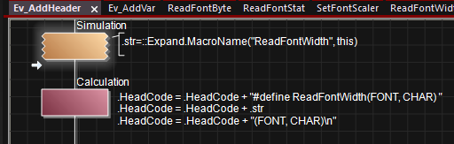

Ben is the master of this kind of thing, but I think you can use it in conjunction with the Ev_AddHeader event. This allows you to change or add to the C code generated for the component.
Here's a snippet from the GLCD_Base component:
Screenshot 2025-12-04 103037.png (25.91 KiB) Viewed 5097 times
In your case, you could potentially create a new function maybe something like this:
.HeadCode = .HeadCode + "int MyNewTransactionWrite(int NewParam1, char* NewParam2) \n"
.HeadCode = .HeadCode + "{\n"
.HeadCode = .HeadCode + "  //do something to create the actual params from those passed to this function\n"
.HeadCode = .HeadCode + "  MX_UINT8 myfont = 5;\n"
.HeadCode = .HeadCode + "  MX_UINT8 mychar = NewParam[2];\n"
.HeadCode = .HeadCode + "  " + .str + "(myfont, mychar);
.HeadCode = .HeadCode + "}\n"
And then call "MyNewTransactionWrite" from a C block. But you could possibly do this instead with a normal Flowcode macro, so I'm probably not fully understanding what you're trying to do.
You can also do some neat things with the C preprocessor - e.g. using ## to concatenate two bits of text before it is passed to the C compiler itself.
No matter though. Hopefully the above gives you some ideas on how you can do what you need.
