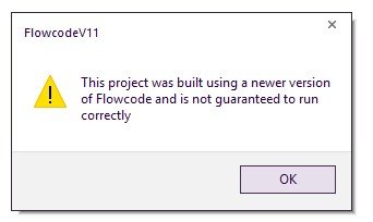

I am not sure if I should be able to simulate it, I don't seem to be ale to do anything?
Strange as well, when I open it in V11 I get this, I am all up to date as well.
Bob
Re: Scrolling line chart
Posted: Thu Jan 22, 2026 9:47 am
by Steve-Matrix
It may be that I created it with a latest development version of v11, but it should work ok. I've just tested it and it's fine.
