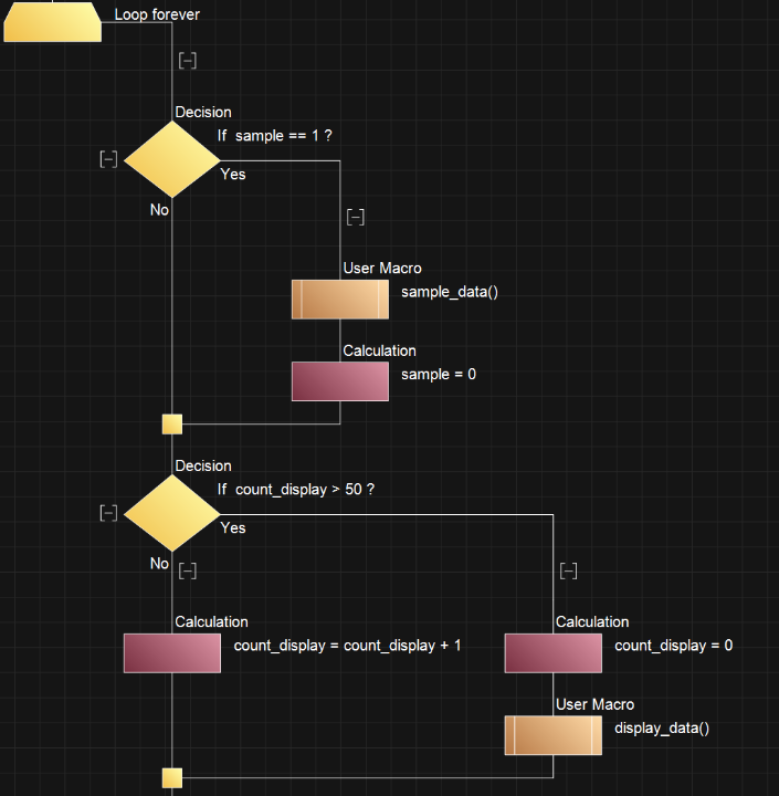

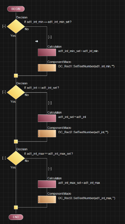

I had the opposite problem from Jorgen: the values on the display were updating too frequently.
So I set it to update the display only after 50 samples, and only for the values that have changed.

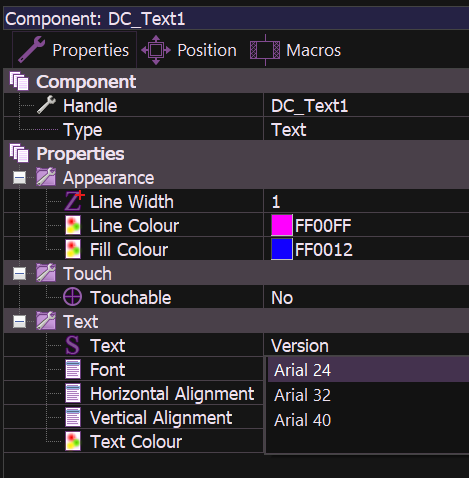

I have one more request for a voltmeter: larger characters, if possible:
add size 48 72 96 120 144
Display update after 50 sample:

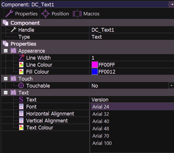

I found the setting. It's the fonts you can create on the display.
So I added some new fonts
Once everything is working, I can post my program
Fonts on Display:
Are the fonts on the manager:

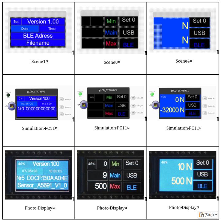

by stefan.erni
Hi Ben, Hi Jorgen
I've integrated the display manager into my program. It's easy to do.
I've tested the scenes in the simulation and on the display, and they work both very well.
In the scenes, you can see the grid, which is practical.
Simulation has no Bluetooth adress and project file name.
The difference in the blue color is due to my camera; on the display, it's a perfect blue.
The display only shows the measured value when it changes.
But when it does change, you see the number build up from left to right.

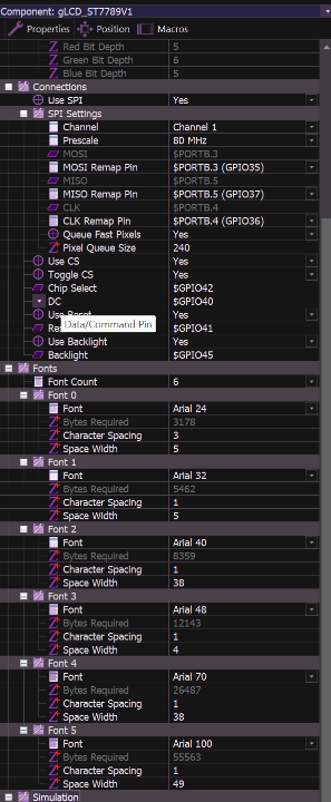

I use SPI with 80Mhz

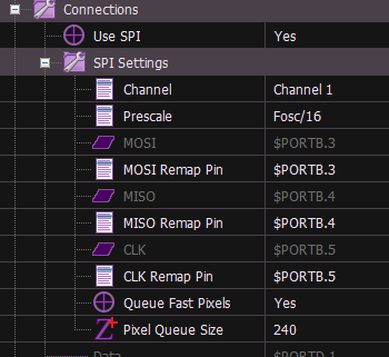

A question: On another display, I was able to enable “Queue Fast Pixels” and the problem went away.
Is it possible to add “Queue Fast Pixels” to the gLCD_ST7789V ?
https://flowcode.co.uk/forums/viewtopi ... 35#p16435
PrintScreen:

Hmm on further investigation the properties are already there in the SPI Settings section. Do you have these set to Yes?
Screenshot 2026-05-08 105006.png (20.26 KiB) Viewed 3421 times

OK, that was already set to “Yes.” I didn't notice that.
The only difference for me is the prescale.
Do I need to increase the pixel queue?
or what can I do?
