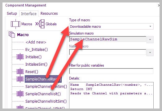

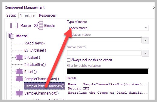

Posted: Wed Apr 07, 2021 5:47 pm
by p.erasmus
If you select the HW macro below it write the Sim macro in by hand ,if FC does not want to take it there is a difference in Parameters between them, I have noticed ,then select the sim macro and set it to Hidden The SampleChannelRaw is the HW (embedded ) macro and the SampleChannelRawSim() is its Simulation macro
Hope this also helps a bit
