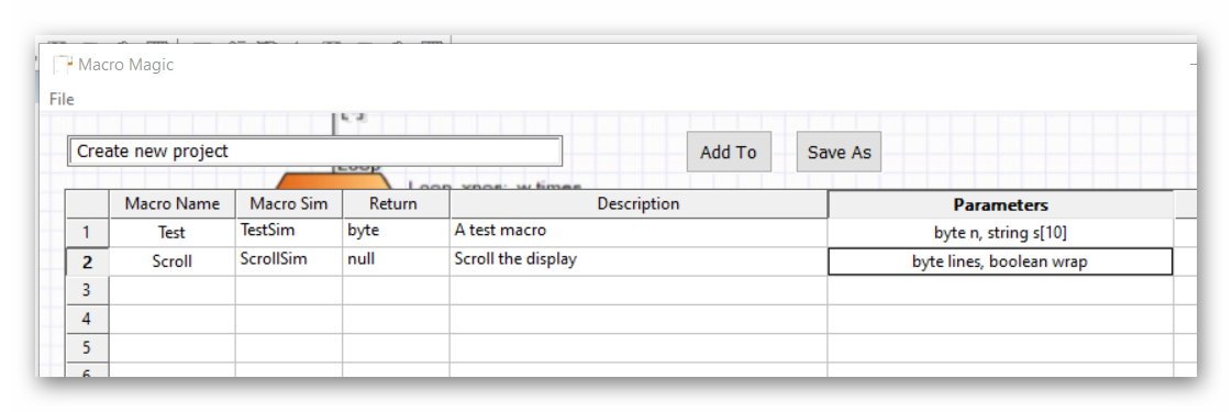

I've added a 'parameters' field. Add any required parameters for the macros using the format 'type name, type2 name2 ... typen namen' Arrays are supported using '[' and ']' (size is also needed for strings but not in return values). Parameters are comma separated and type can be bool or boolean, float or real, int, uint, byte, long, ulong, string or handle as before)
So a possible entry in Parameters would be 'byte number, ulong values[10], string str[20]' (without the quotes) which would add 3 parameters (number, values and str) to a macro.
There is (absolutely) no error checking - so adding something like byte x[2v] probably won't cause a crash - but won't give the 'expected' result either.
In retrospect - I probably should have had one column per parameter. However - as it is currently would allow 'locals' to be added very simply.
Would create four macros (Test and Scroll marked as downloadable and TestSim and ScrollSim as their simulation counterparts) Note that the simulation names do not have to end with 'Sim' but do by convention.
