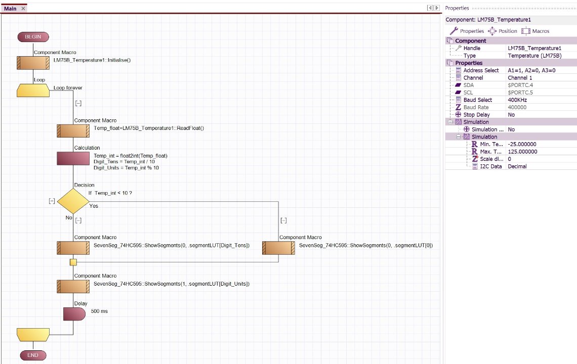

Hi medelec35,
I have tested your new component, and it works.
Screenshot 2026-07-13 122709.jpg (110.97 KiB) Viewed 950 times
Thank you for the offered customization! :)
Andreas

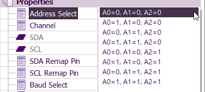

Hi Andreas,
You're welcome.
I'm glad it works for you.
But I do apologise over the Addressing.
After checking on the datasheet, I should have started with A0, not A1
I have attached the corrected component that addresses as follows:
LM75B Address selection2.png (17.29 KiB) Viewed 950 times
