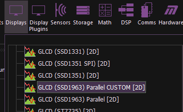

I've taken your initialisation and your data / register commands and put them into a custom version of the SSD1963 component source.
You can add the component to your copy of Flowcode by copying this file here: C:\ProgramData\MatrixTSL\FlowcodeV11\Components
gLCD_SSD1963_Custom.fcpx
(18.31 KiB) Downloaded 3 times
The programdata folder is hidden by default so copy and paste the address into the file explorer address bar to get there.
Restart Flowcode and the new component should appear in the menu.
Screenshot 2026-09-21 111409.png (13.48 KiB) Viewed 205 times
Hopefully this should allow your display to work on hardware and also to allow it to be part of the simulation and display creator WYSIWYG eco systems.
