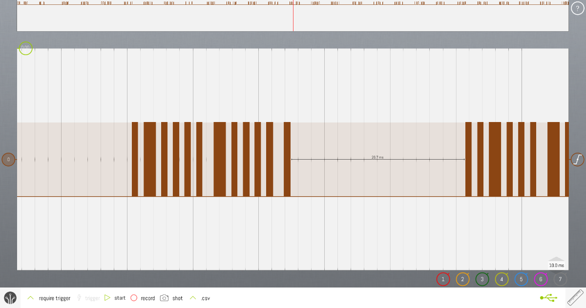

As I couldn't get the component to transmit - I modified my code above to the 12f1840 (**** actually 12LF1840 - you might need to change this).
This gave:
Note that one slight oddity - because the transmit is interrupt driven (and doesn't wait for completion at the moment) - the delay after the SendRC5 must be long enough for the transmission to complete. I used 50ms which gives ~25ms between transmissions - however the RC5 protocol requires more time than this to allow the AGC to cope!
The code uses two bits of C - one to enable a custom frequency for a carrier of 38kHz and one for a custom timer.
