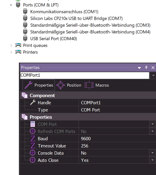

Hi Oscar, Hi Ben, Hi Steve
I like to use this auto comport too. But when I use the program from Ben, it don't shows me a port, even I have some.
What do I wrong?
Re: Automatic Com port Select
Posted: Mon Jun 28, 2021 4:48 pm
by Oscar_T
Hello Stefan

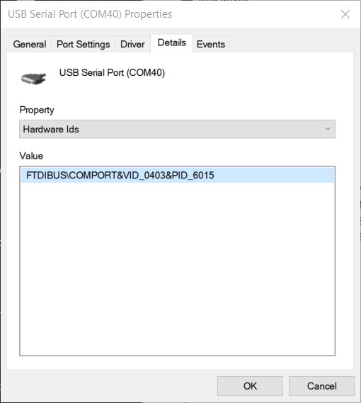

Which com port are you trying to open? the number 40?
Have you modified the VID/PID?
Posted: Mon Jun 28, 2021 4:50 pm
by stefan.erni
Hi Oscar
Yes
Posted: Mon Jun 28, 2021 4:57 pm
by Oscar_T
Is a FTDI Device?
I have tried several units (always with the same vid / pid) and they are recognized and numbered correctly.
I also tried to run the program on different computers and for now all fine.
Have you installed the official ftdi drivers? Have you installed the new dll?
Excuse me if these seem trivial questions to you but sometimes the problem is just a simple thing
Posted: Mon Jun 28, 2021 5:52 pm
by stefan.erni
Yes driver is new and the VID and PID look like the same value.
Dll is copied.
Posted: Mon Jun 28, 2021 6:14 pm
by Oscar_T
And if you go to the windows registry you find the same thing?
Posted: Mon Jun 28, 2021 7:39 pm
by stefan.erni
Hi Oscar
Thanks a lot for your help. It's working now. The problem was the dll.
I copied it to an "old " folder with an old FC9.
So this autodedect comport is really a good thing.
