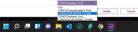

I am unable to use Flowcode with Windows 11 Pro. Despite I have installed the USB driver, I can't see the Programmer Port being listed and n/a only gets shown. Is it just me that has this problem, or is it a known issue that will be addressed in a future release?

Hi Andreas.
What is your target device?
I'm running Windows 11 Home as from last night and have not experienced any issues with Flowcode v9
I have four boards plugged in:
Sparkfun Redboad
Arduino Uno
Arduino Nano
BL0011
Windows 11 & FC9.png (33.07 KiB) Viewed 11840 times
Only the top three target devices will be shown, but all four boards I have just programmed this morning with no issues.

I confirm that I have made it to work today and I no longer have issues with Windows 11.
I was missing the AVR Compiler Toolchain and some USB drivers from Arduino. :roll:
