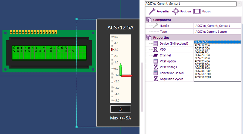

I have included all of The following components
ACS7xx Component.png (114.6 KiB) Viewed 8574 times
As promised, the component should now be available via the update system.
I would recommend you set the Acquisition cycles to at least Fosc/64 for all the current sensing components on the Ardunio.
For anyone else interested, I have added the component to the Sensors pack, so you will need to have that enabled before you can use the component.
