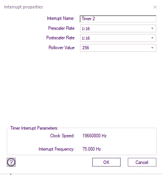

I have just downloaded the flowchart I have posted & the Timer 2 properties looks like they have changed.
These should be the correct settings:
Timer2 interrupt settings.png (22.95 KiB) Viewed 12702 times

Thank´s Martin. I see now, to fast the old timer. I test later today /afternoon and you hear. I have send you a PM :D
