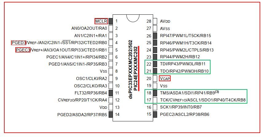

I tried your idea with the c-box. Result is the same like before.
Pin 17,18,21 and 22 are not toggling. All other pins are working. Switch off the comparator modul gives no success.
Setting ANSELB to 0 is although not successfully.
Any idea? This would solve in the end, that the oled modul will works.

Measuring with an oscilloscope:
Pin 15 = toggling
Pin 16 = toggling
Pin 17 = GND ???
Pin 18 = +2V ???
Pin 19 = GND
Pin 20 = +2V (vcap)
Pin 21 = GND ???
Pin 22 = GND ???
Pin 23-26 = toggling
Pin 27 = GND
Pin 28 = +3,25V
Is it a help, while pin 18 have +2V?
This is no digital value.
In an older project there was a similar problem. After some days I found the error.
For this pin i needed, I have to switch off the comp-modul. Was not clearly to read out of the datasheet.
Are there any pullups to switch off or anything else?

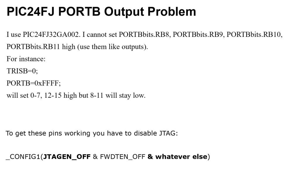

I found in a forum the following information to another cpu:
toggle problem port b_Forum.jpg (62.05 KiB) Viewed 13044 times
Jorg
Re: GLCD SSD1327 SPI needed
Posted: Fri Oct 22, 2021 11:51 am
by BenR
Aha that's a good find, have you tried changing the JTAG enable bit in the Build -> Project options to Disabled?

I did it and now port b is complete toggling.

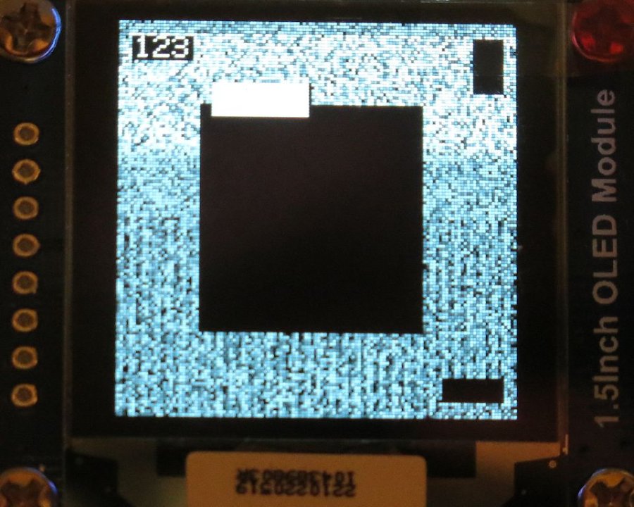

Here now the screen of the display:
SSD1327_first impression.jpg (140.8 KiB) Viewed 13022 times
What in the first moment not works, is the "clear display" function.
Placing text, rotating display and rectangle runs. Rest will be tested the coming week.....

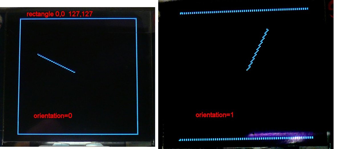

Display orientation: turns 90° / display pixel are set not correct(see picture) --> math not correct

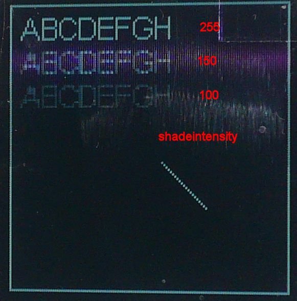

Shadeintensity: 255 --> OK
150 pixel not correct set / differant colours --> not correct
100 pixel not correct set --> not correct
(see picture)

I beleive the text and pixel functions are now working correctly at all orientations which is a great start and the clear function should also be working now too.

All was working now. You are the greatest! The idea with refresh is although working.
It`s a good idea! Another great jump forward is the possibility to choose fonts for
text. This is now readable for older users and looks more professional.

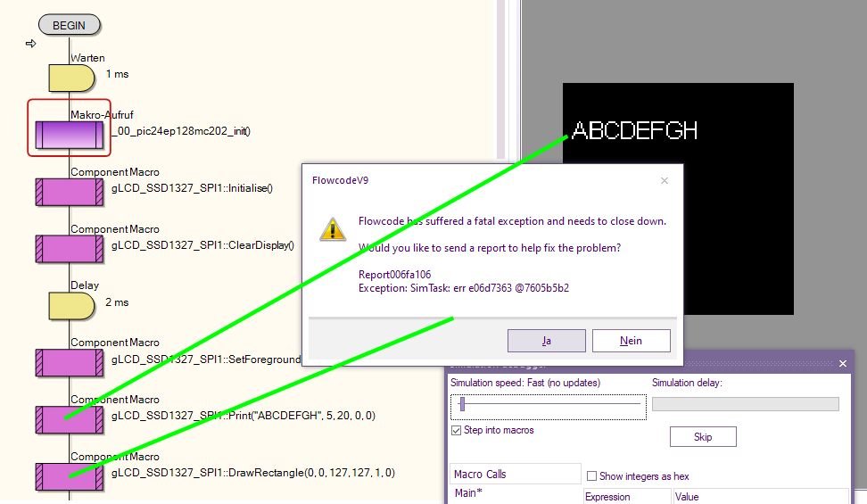

Debugging inside fc9 with the display let errors occur. The picture below shows,
that the text is displayed, but the rectangle stops the program. The time from
starting debugging to the text is very long.
SSD1327_simulation error.jpg (87.58 KiB) Viewed 12903 times

Aha think I might have found it, try changing the Simulate Comms component property to No and this should allow the display to run correctly in the simulation.
I'll edit the component and set the default value for the property to no. Yes allows us to drive a real display from within the simulation runtime via an API slave device.

you`re right, now it`s running without errors and quicker.
A good description to that point in the help document would be good.
Great done from you!
