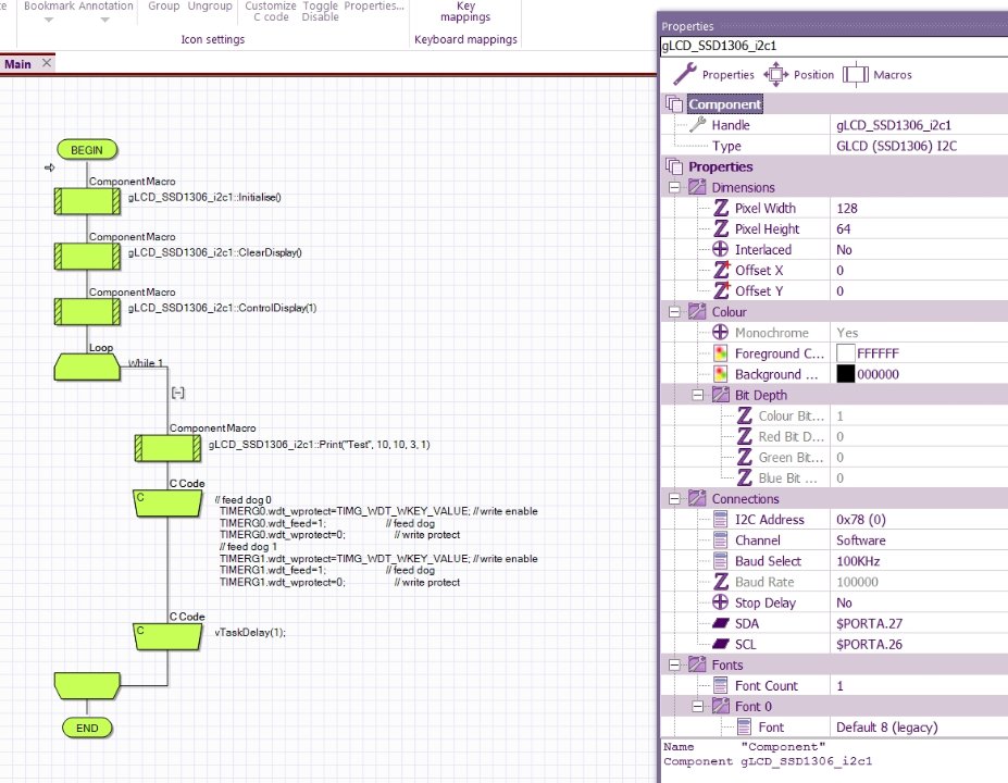

by MJU20
Hi Leigh,
The FC program looks like this at the moment:
This is how it's at this moment, I've been fondling with settings all the time.
Including changing stuff in the sdkconfig file.
Have a nice holiday!
