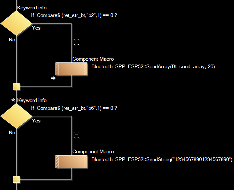

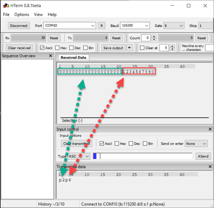

There is still a problem sending string with ESP32 by bluetooth.
If the string is longer than 10 char then bluetooth will crash and hang until a hardware reset.
Strange that sending a byte array of 20 byte with "0" is without problems.
So I have updatet all files from flowcode and use a program with the interupt from the bluetooth (Macro bt_interrupt)
to receive command from a terminalprogram
If I send "p1" the Modul send me back 20Char of "0". this is working very fine and many times without a problem.
But when I send "p6" the Modul should give me 20 char back, but it's crash and hang.
Generell sending string is working, if the string is less than 10 char.

That's odd - the SendString code effectively calls PutBytes(temp[1], 1) once for each character - whereas SendArray just sends the entire array using PutBytes(data[n], n).
So they call the same 'backend' code - just SendString calls it (in this case) 20 times with an array of 1 character each time.
Does SendArray crash if called multiple times in rapid succession? (Try SendArray(n[1], 1) - 20 times in a loop?)
Very strange...
One 'kludgy' fix would be to cast the string data pointer to a byte pointer and then call SendArray(data_ptr, StrLength(data)

I tried it on different ESP32 modules and it wasn't always 12 chars, sometimes it was more or less. But a string with 6 char always worked, even in 100mSec pooling time. How can flowcode send the whole string at once?

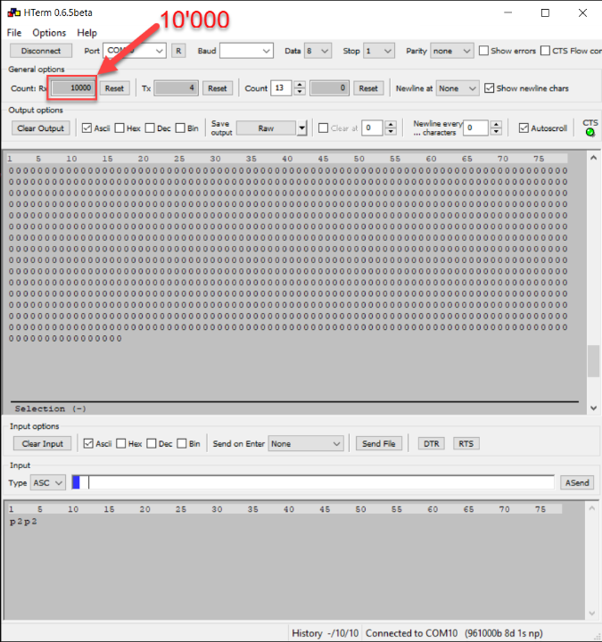

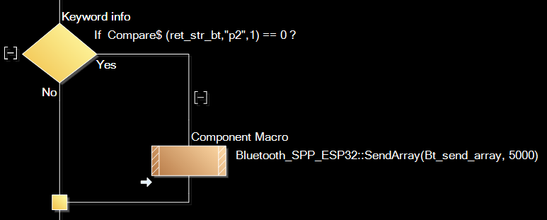

I made a test with the byte array.
I have increased the array to 5000 bytes !! and I can send this twice (or more times) without any problems
