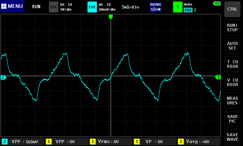

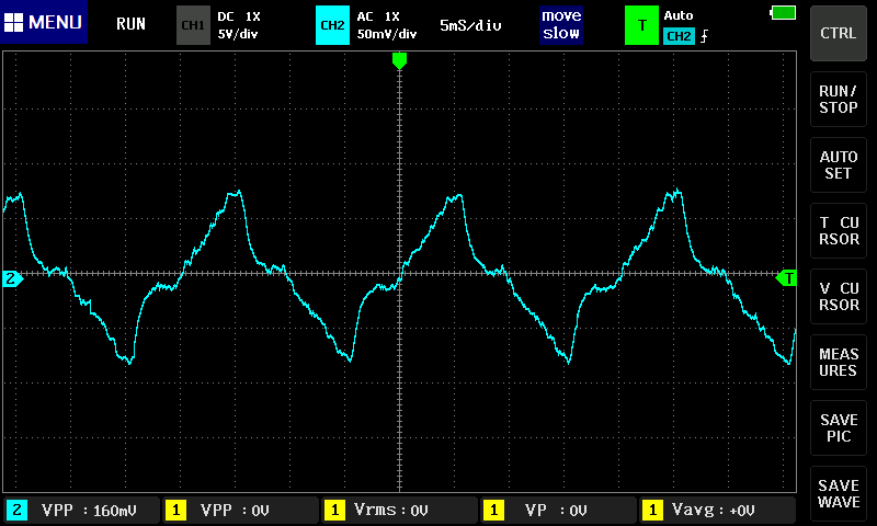

For anyone else interested in the subject. This is a scope measurement from the ct with a few led lights on and a tv

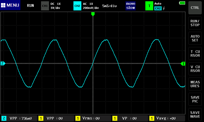

switch on a heavier linear load (kettle)
Although the kettle is almost 100% linear you can still see the affects of the non linear load at the peak of the waveform
