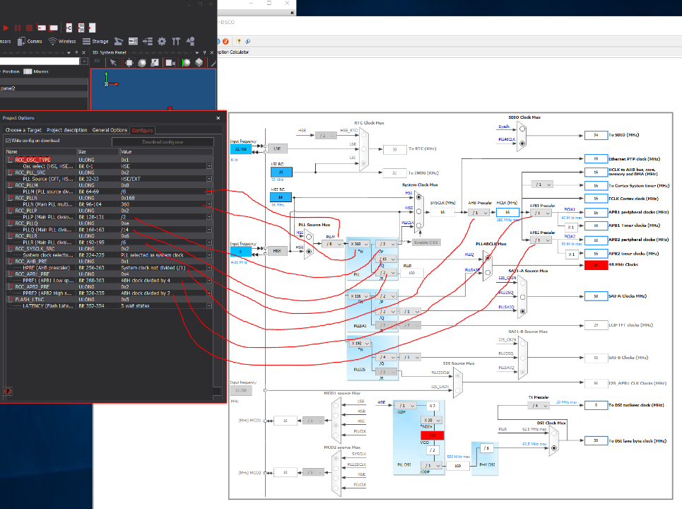

In the Build => project option you can set some.
This is a sample, maybe not exactly from the PIC32MZ2048EFH100
but the way is the same.

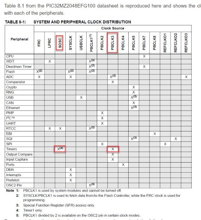

You can see in the distribution picture, timer1 is different to timer2...timer6

Hi SpeedPIC32
Here the picture more readable.
It's from a PIC but not from the EFH100.
