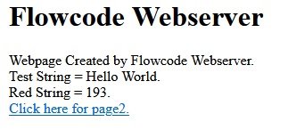

Loaded the example you posted onto my Pi and it's working great, auto refreshing every second, left it running for several minutes and so far it's not skipped a beat.
If you manually refresh then that might create problems as it's auto refreshing so often (though even doing this it's doing great and not missed a step). I would maybe increase the auto refresh time in the index html code and see if that helps things.

I did a totally clean install and everything is working fine, the only things that I think were on the other card were VNC and a sense hat as I had tried the sense hat example. It is updating and I have swapped pages quite a few times now and no issues.

Well it seems to be working I've got basic read/write working and also allowed the webserver to connect to the file system and so far I think it's all ok.
There's probably a bit more polishing that could be done but for now there's a demo of the RPI webserver here.
