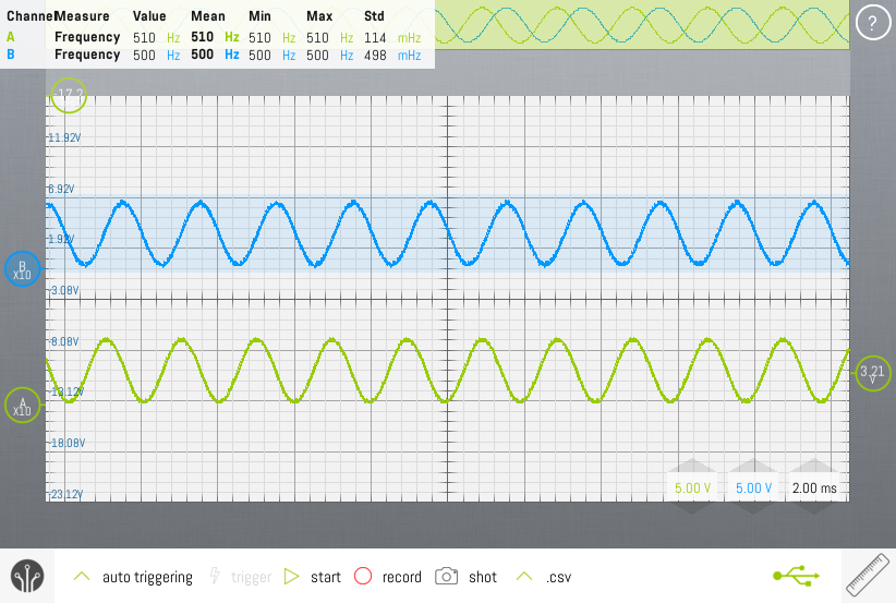

A quick idea on binaural beats - which as far as understand are just created by having a slight 'difference' in frequency between left and right channels (played through headphones for best effect)
The above code was easy to modify to allow 2 (or indeed more) ad9833 chips to be connected to the same SPI channel (I don't think we need much horsepower here?) - and then frequency can be set by using SetFreq(channel, wave, frequency). This could easily be modified to have a SetFreq0 and a SetFreq1 (naming subject to revision) - though at the expense of some more code duplication.
I tested by setting pins d10 and d9 as FSYNC0 and FSYNC 1 (in properties) - and then setting two different frequencies to channel 0 and 1 in main. Will have to do a little more soldering to test with two chips - so just moved the jumper from d10 to d9 and watched the result on the oscilloscope.
Next - wire up the second breakout and connect to an amplifier / headphones ?

Note this is pretty much the previous code - but in cal_spi I've set Use Auto CS to No and use the FSYNC pin properties to handle the relevant CS pin.

Just tested with 2 x AD9833 and seems to work as above. Next step a small amp and some 'phones.
