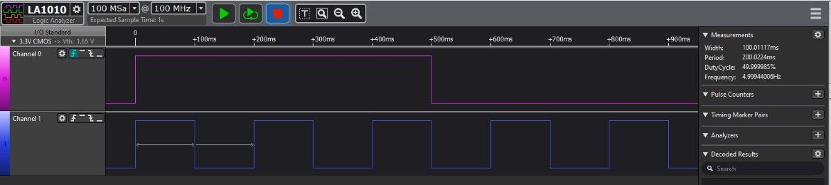

Hi Leigh
Huge thanks for this, works a treat.
With this extra power surely my world domination is a few steps closer :)
Best regards
PS
Pico Dual Core.jpg (41.5 KiB) Viewed 4349 times
