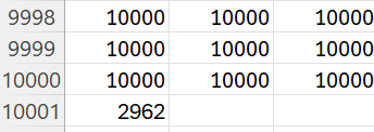

Here a program to test the SD-Card:
Press a key to start (GPIO19 on my board)
The program write 10'000 line in a .csv file
Its write a string of 128Byte for each line (21 times a fix number 10000,)
If writing is finish it's write the time in line 10'001 in mSec and it send the time to USB
Test_post_sd_0525.fcfx
(33.22 KiB) Downloaded 285 times
I tested with different setting for the card
the setting from the clock to 1Mhz, 20Mhz, 80Mhz is no difference
the setting 1Bit or 4Bit mode=> 1Bit=2935mSec 4Bit=2551mSec :)

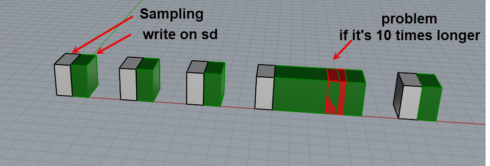

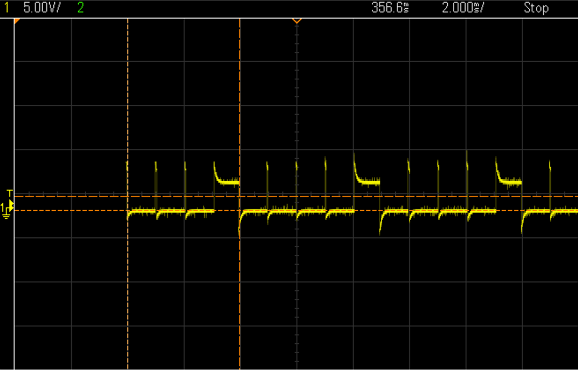

My wish is that the writing of 128Byte always takes the same time or that there is not such a big difference to write the string
test shows the time to write for 128Byte, you van see every 4te string is much longer ( with a 1mSec delay on)
here the 4te string
and sometimes it's much longer...

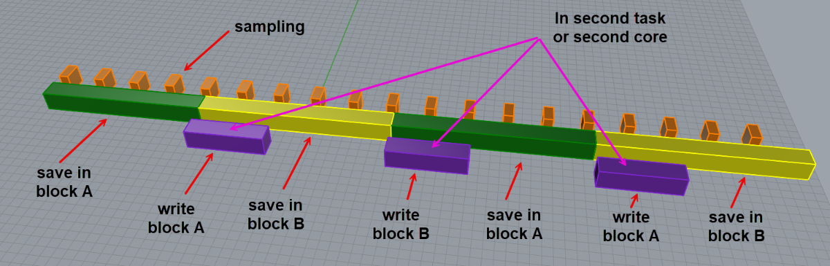

Yes I have a second program to write two buffer (array) of 12000 integer to wave file. Its working
The problem is in the csv Version to write csv file.
It's very easy to sample and save if I reduce the samplerate.
but if this different time would be less, the csv version would just work without buffer and second task/core
compare:
csv version
wave version

If it is not possible to improve the times for block writing,
I'll test the version with the additional task in more detail.
Maybe I can also find a simple solution to store the strings in two buffer's and then write them to the sd-card alternating.

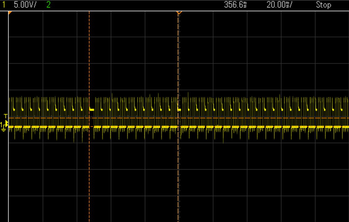

I testet the time to write one buffer (12000Byte) with the Oscilloscope with pinned to core 0 or core 1
pinned to core
0/1
to write a buffer with 12kByte it need
336mSec/380mSec
per second
35.7kByte/31.5kByte/
power consume Board
75-90mA/75-110mA
C-Code
