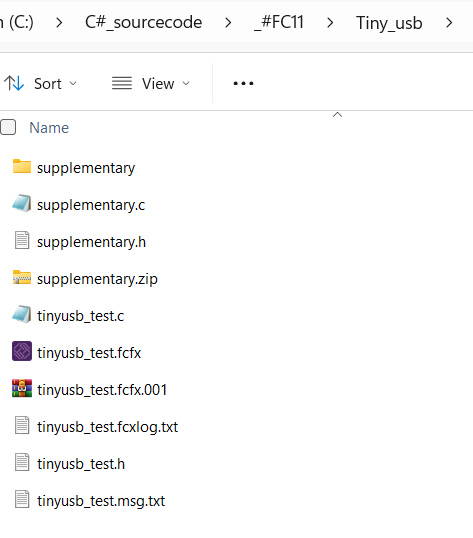

ERROR: Directory "C:\C#_sourcecode\_#FC11\Tiny_usb\main" does not exist! Please specify a valid component under C:\C#_sourcecode\_#FC11\Tiny_usb or try to use --path
C:\C#_sourcecode\_#FC11\Tiny_usb>ERROR: Directory "C:\C#_sourcecode\_#FC11\Tiny_usb\main" does not exist! Please specify a valid component under C:\C#_sourcecode\_#FC11\Tiny_usb or try to use --path

I made a copy of supplementary.c supplementary.h from the supplementary folder to Tiny_usb
I did not help...

May also need "main"?
Re: ESP32 UART-USB Brige How to use
Posted: Thu Dec 04, 2025 9:41 am
by mnfisher
Yes - supplementary.h & .c need to go into tiny_usb (project directory) /main/includes - and add includes to CMakeLists.txt as above.

ok I create main and all...
In file included from C:/Users/Kfs-Forschung/Desktop/esp-idf-2/mtxesp32_s3_sdkconfig/main/esp-project.c:20:
C:\C#_sourcecode\_#FC11\Tiny_usb\tinyusb_test.h:64:10: fatal error: supplementary.h: No such file or directory

Odd - the main directory should be created with the project - you could try either pasting the .h and .c files into the supplementary code (instead of the #includes) or give them a fixed address (#include "c:/test/file.h")

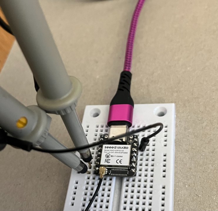

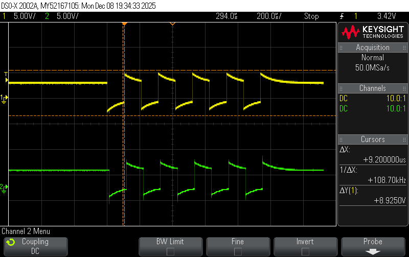

The image shows how UART0 and UART1 work and, incidentally, how UART1 is only slightly delayed and not, as assumed, only when uart0 is finished.
