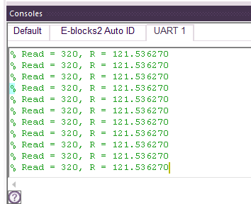

Hi Bob.
Have you changed the PullupResistor value ?
With it being 267, it's working on my hardware and simulation.
This is the embedded UART results:
Hardware results Read 320.png (8.63 KiB) Viewed 3032 times
Calculation:
read 320 calculations.png (10.85 KiB) Viewed 3032 times
Simulation results:
read 320 simulation results.png (15.68 KiB) Viewed 3032 times
As you can see they all match.
They are the results you should be getting.
If not I will take another look at your latest fcfx project file.
