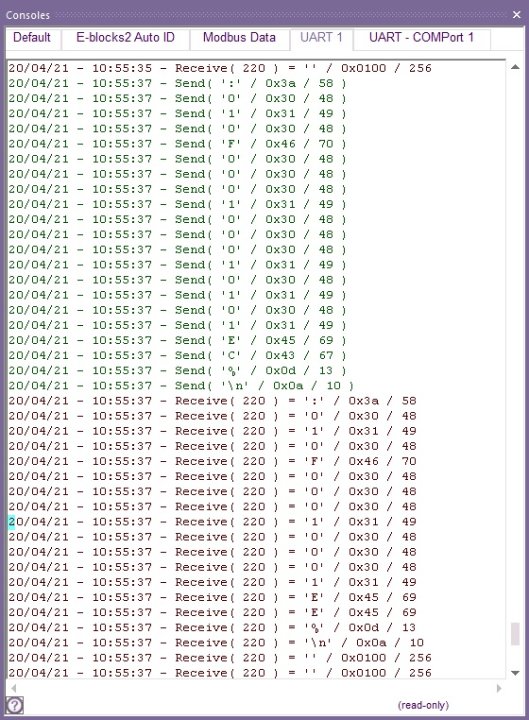

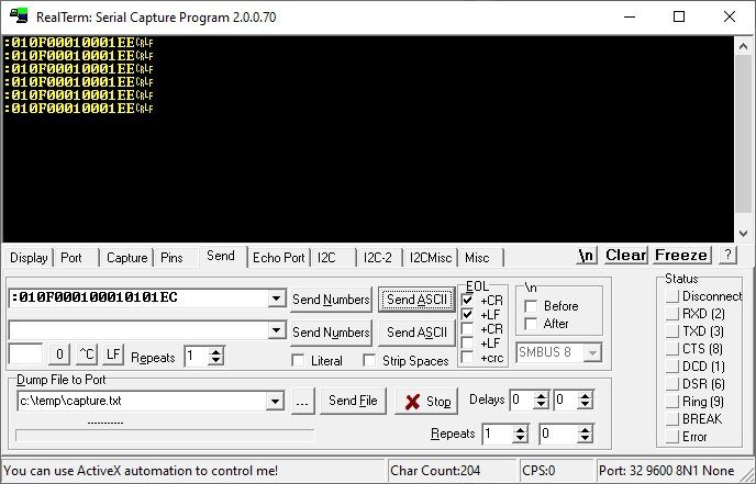

Hmm this is odd,
If I send the command using Flowcode then it works and it replies.
Also if I use a terminal program to send the command then I get a reply with this too.
I'm using an Arduino Uno. I'll try again now with an ESP32.
Edit. ESP32 certainyl seems to have a problem at the moment, we are investigating.
