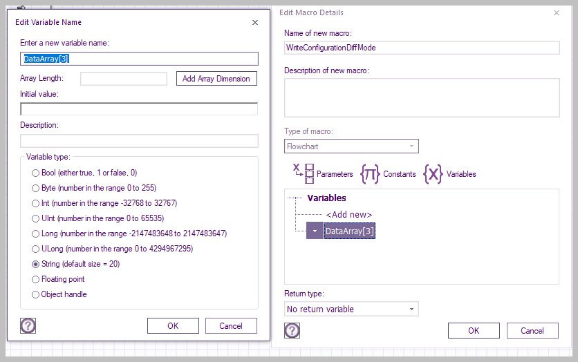

I ran into an issue I made a small project for the ESP32 Lolin board and I wanted to just write a simple configuration to the I2C device and in the main loop switch a led on and off, to start too learn how to use this transactions macro`s :oops:
In FC chart the call is now disabled and I could program and my led is flashing.
All is working until I call the Transaction_write then the build fail and obviously no programming.
I am not sure what I am doing wrong please help.

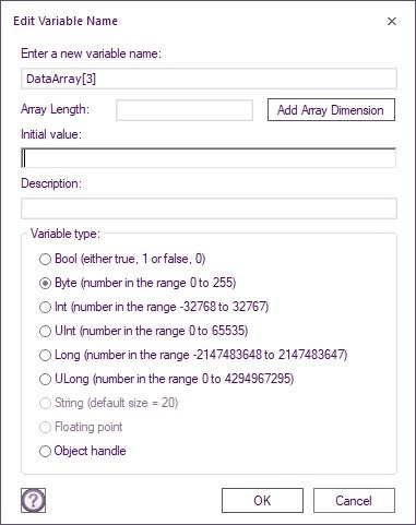

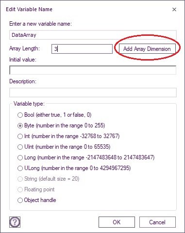

Please could you change your DataArray from a string to a byte array
Default ESP compiler settings are somewhat pedantic about signed/unsigned mismatches

Re: esp32 i2c is not implemented yet
Posted: Fri Apr 23, 2021 9:53 am
by LeighM
