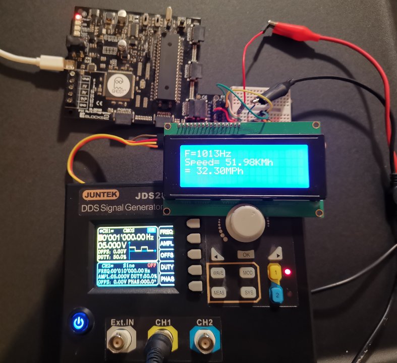

Flowchart used: Doppler 16F1937.fcfx
Using Eblocks BL0080 with 16F1937
The only thing I had to do was change the address of my backpack as its 0x63.
Connected signal generator to C0 & GND.
Connected backpack LCD to : SCL = C3, SDA = C4.
Selected 1KHz CMOS O/P from signal generator.
Worked first time with 16F1937:
Hopefully, you can see the display OK?
