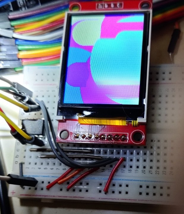

Looking at the CAL_SPI TransactionWriter code - it just call Master_byte multiple times - so I can't see why the transaction version doesn't work - but tried it again and it doesn't :-(
Sorted - It wasn't working with transactions because the buffer in Initialise was too small (I'd initially left out the gamma adjustments which needed 16 bytes...)
