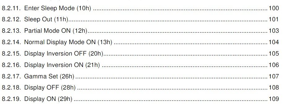

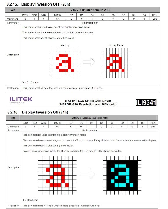

Ok. It's not the reset pin. It's the backlight pin B0. If I set the pin by set port, the display is working.
Flip x, Flip y I saw the propertie and it's fine now.
Color:
I have the cyan color on my display if i expect red.
If it's possible to add this color invert command ?
or few commands more like this?
And a remark: On my board is a ILI9342 controller and it's working fine even with the ILI9341 component

Hopefully both issues solved for you now via library updates.
I've fixed the LED pin problem and also added a new property to allow the colour to be inverted/uninverted.
I can expose the send reg and send data macros if that would help to allow for full control.

It's perfect now. Thanks a lot.
Colors are correct and and the pin is working.
Yes please expose the "send reg and send data macros"
I hope I can set some power save mode for the display.
