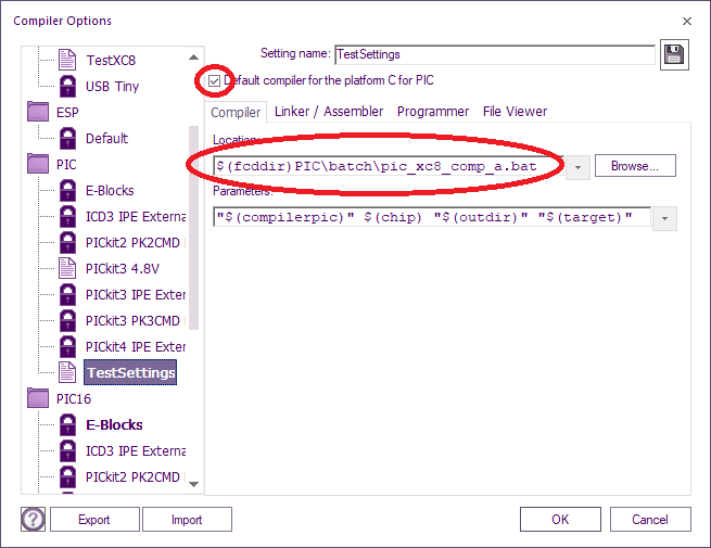

I try to save without space in the name, but no difference. I also try to "restore Compiler options" it is not possible to dele the new Pic629 I create with your path. Every time I delete it and save it look like it is deleted, but when I opened Compiler options it is again back? I try to uninstall FC9 and reinstall again but still not deleted, look like the XC8 not is reinstalled.

Not sure why you would need to delete the compiler option, just check that the default tickbox is set for the version you want to use. If you really want to remove a custom setting then you may have to do it via the registry.
Computer\HKEY_CURRENT_USER\SOFTWARE\MatrixTSL\FlowcodeV9\CompilerSettings
Have you refreshed the configuration settings in the project options like I suggested?
What errors are you getting when compiling using the E-blocks and the new alt compiler settings?

Ok please make sure the default compiler option tickbox is checked for the new _a compiler batch file.
Also make sure that the configuration settings are ok for the chip to run, the program I posted is using the INTOSC and is working ok for me on the 629 chip I have here.
