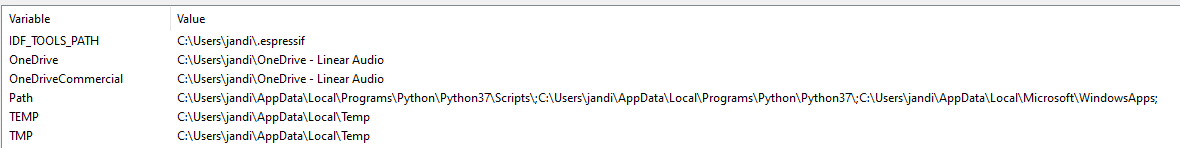

Re: Installing and setting up of ESP32 toolchain
Posted: Thu Jun 01, 2023 1:23 pm
by jandidden
These are the environment vars in the working system.
westende environment vars.PNG (14.47 KiB) Viewed 16747 times
