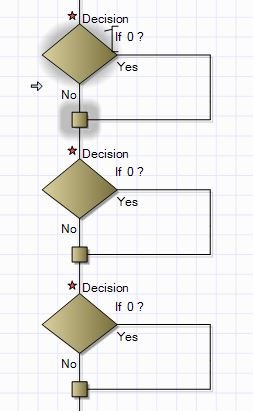

Re: Protocol j1587
Posted: Tue Jan 30, 2024 1:22 pm
by chipfryer27
Just remembered you are actually receiving dump of Hex (I think), so in your main loop, test for each "match" sequentially instead of going to the end of the loop after a match is found.
So have a decision for Char 14 and in the"yes" branch, process.
Then after the above, have another decision branch for 6 and process.
Then after the above have another decision branch for 16 etc.
That should give you the values.
Decisions Decisions Decisions.JPG (25.76 KiB) Viewed 6343 times
I can understand it being slow but once you can capture all your required data we can look at how to improve.
