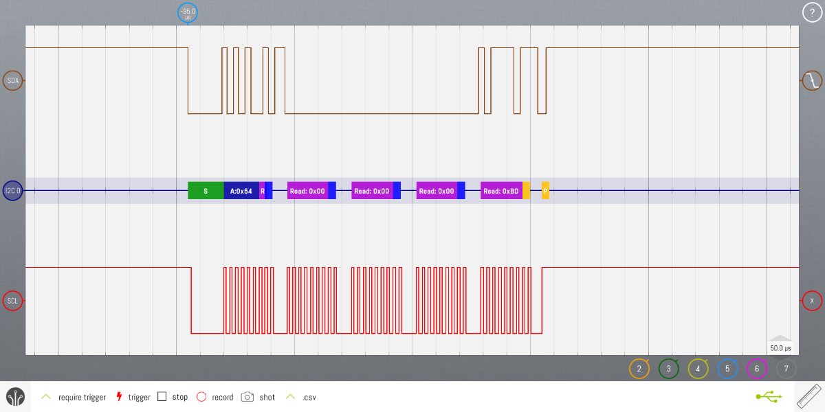

On the oscilloscope it shows as:
Note that I disable / enable the interrupts around the code that writes the data to 'reply' ready to be written (to prevent a partial result being transmitted)

Note that here the master is requesting data from the slave every 200ms (so in this artificial demo - the reading should change every 5 readings (approx as UART takes a little time too))
