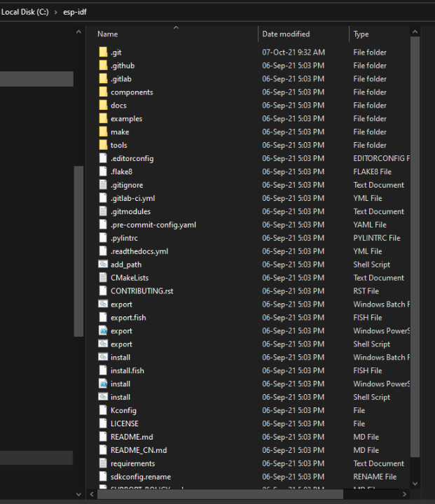

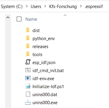

Just from my experience when I created the esp-idf folder it automatically creates another folder espressif and puts the file in that when I forced it to install in the esp-idf without the espressif folder everything worked.

@Jollybv You mean for the second folder (.expressif) you choosed the same folder (on Desktop esp-if). I will try that.

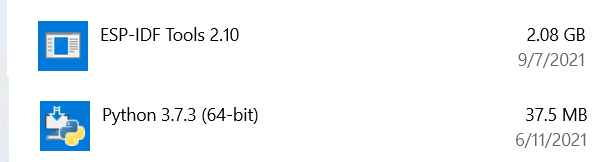

@ Leigh Here is the version of Python and ESP-IF Tools on computer 1 (the one where works well) I will see what version are on the other computer and check if there are more than one version of Python.

Hi yes
you need to load it into just the ESP-IDF folder

There is the same Phyton but there is a Phython Launcher on the bad computer
