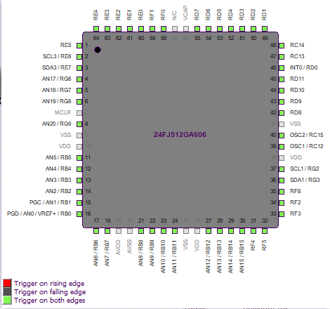

Hello
Thanks for your help, the project is going well.
However, the interrupt does not proceed.
And how do I set the IOC Port?
What is the meaning of red black green in the picture?
How do I set it up?
Thank you for your help as always.
Re: PIC24FJ512GA606 download error!
Posted: Mon Feb 14, 2022 8:26 am
by medelec35
Hi.
seokgi wrote: ↑
Mon Feb 14, 2022 6:34 am
It looks like there is a bug in the dark theme as the font is changed to white on a white background.
If you change to the light theme it will show you:
IOC Key.png (27.27 KiB) Viewed 7470 times
Not all microcontrollers allow you to have control on both rising and falling edges.
To change the state of each pin you will need to click in the actual pin.
Change pin state.png (1.81 KiB) Viewed 7470 times
Unfortunately, all the pins are enabled by default and currently, if there are a lot of pins, you will need to unselect all not going to be used.
Otherwise floating pins could cause IOC ISR triggering.
Edit: Issues have been reported.
Posted: Mon Feb 14, 2022 12:19 pm
by seokgi
Thanks for your help.
FC9 is set to Light Mode. The text on the screen looks fine.
However, Trigger on Rising (RED) is not set. I want to set RD0(INT0), RD11(Remap INT1) to Trigger on Rising. Interrupt does not work.
