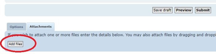

The images do not give us enough information, please attach the Flowcode3.msg.txt file ...

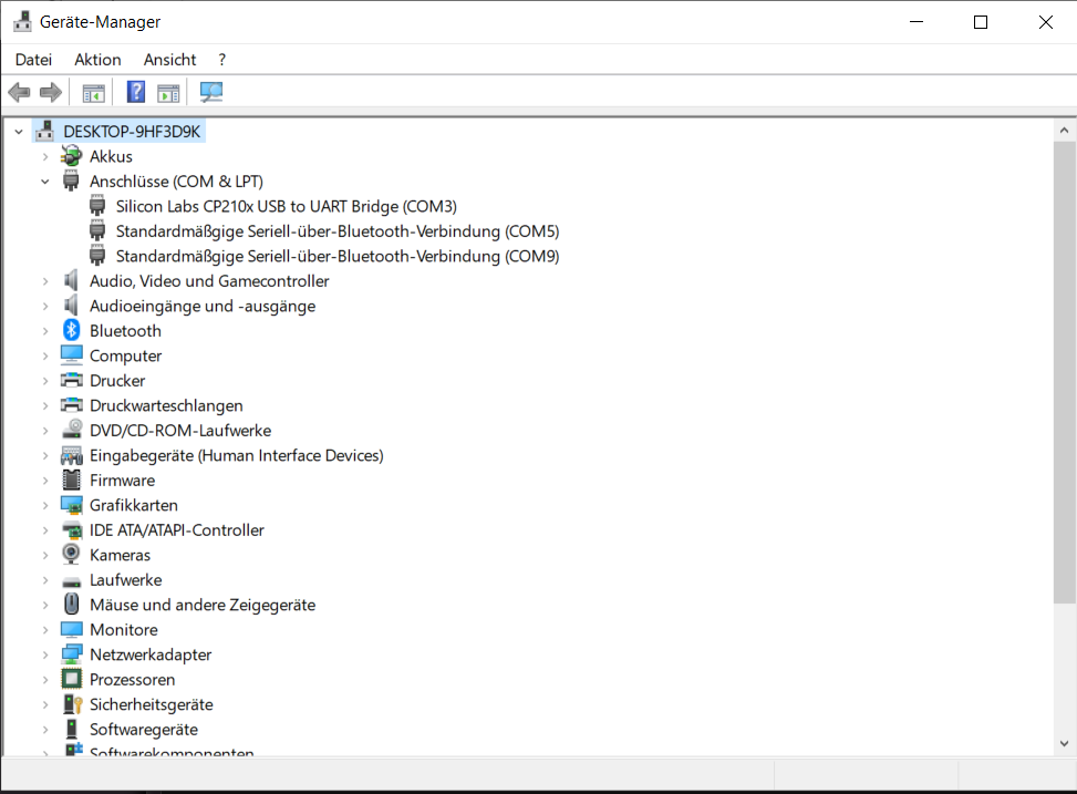

Posted: Thu Mar 18, 2021 12:02 pm
by dvcam99
Hello Felix
first I would suggest to just compile your programm just as a HEX file.
If this compiles OK the main part of the toolchain seems to be OK. If not different story.
Secod step compile and prog/flas your ESP32 device.
With my ESP32 WROOM device wich I bought from AZ Delivery there is no need to push any button in order to prog/flash.
It will be progged always direct from the FC9 surface.
In case that progging is a problem check your device manager that the ESP32 is available under COM ports.
Pls. see the following example:
In my WIN10 case it is installed under COM3 as Silicon Labs
BR
Dirk
