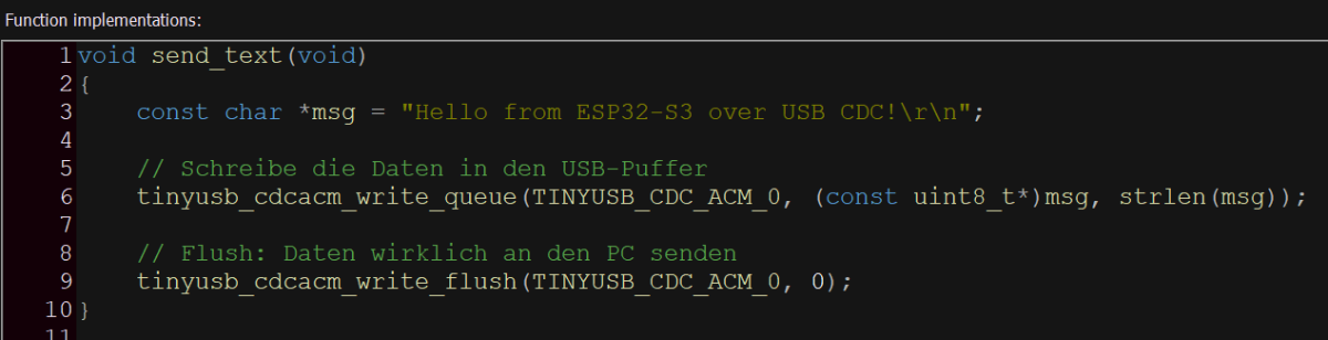

Re: ESP32 UART-USB Brige How to use
Posted: Mon Mar 30, 2026 11:06 am
by mnfisher
Hi Stefan,
Yes - you can use the C to initialise - rename (app_main) initialise (or some such) and add a function definition to the 'includes' (top) box of supplementary code... ( void initialise(void); ) Remove the loop (and the 'hello world'?) from the end of the function...
Then call initialise(); from a C block.

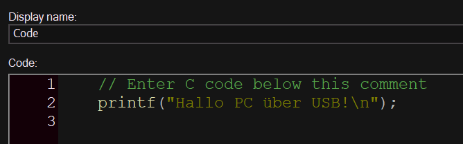

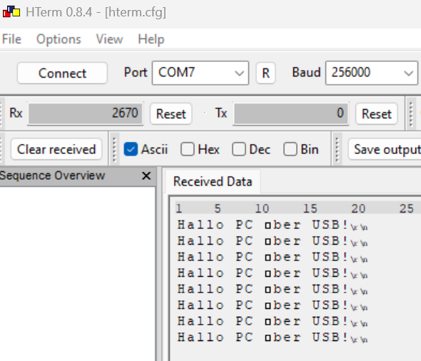

Posted: Mon Mar 30, 2026 1:03 pm
by stefan.erni
Hi Martin
Thank you Martin I'll give that a try.
I've had a bit of success with `print_F` so far.
I still have no idea how to send an array
Very short program:
Post_esp531_1.fcfx
(9.77 KiB) Downloaded 494 times
C-Code:
On computer (regardless of the baud rate)

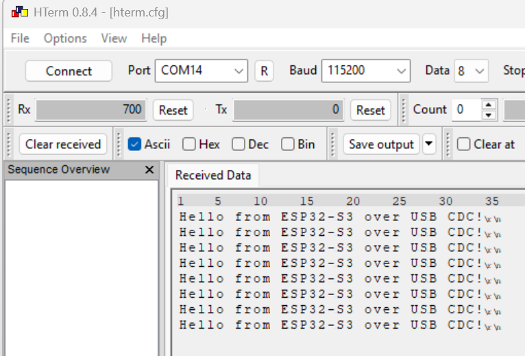

Posted: Wed Apr 01, 2026 11:12 am
by stefan.erni
Hi Martin

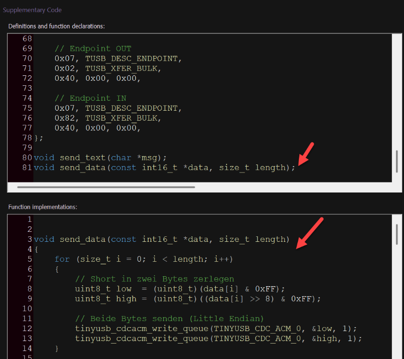

Your suggestion works perfectly!
I had to make a few adjustments. Sending is done using the function in the additional code. How can I send an array from my program? I'm not sure exactly where I need to add FCV_.
Post_esp531_3.fcfx
(13.91 KiB) Downloaded 448 times
Posted: Wed Apr 01, 2026 11:58 am
by mnfisher
Hi Stefan,
Something like this?
Post_esp531_3.fcfx
(12.4 KiB) Downloaded 438 times

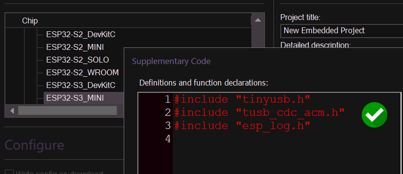

Posted: Wed Apr 01, 2026 12:02 pm
by mnfisher
I commented out a couple of the #includes in supplementary code - you'll probably need to re-enable....

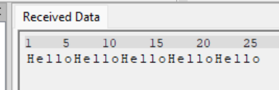

Posted: Wed Apr 01, 2026 1:54 pm
by stefan.erni
Hi Martin
I expanded your example to include an array for sending data, and it works.
I can also receive the binary data array very easily using the Flowcode APP Developer. :)
Demo:
Post_esp531_4.fcfx
(13.77 KiB) Downloaded 493 times
