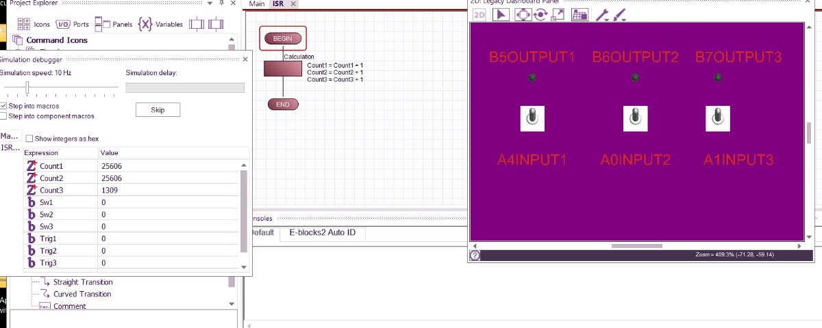

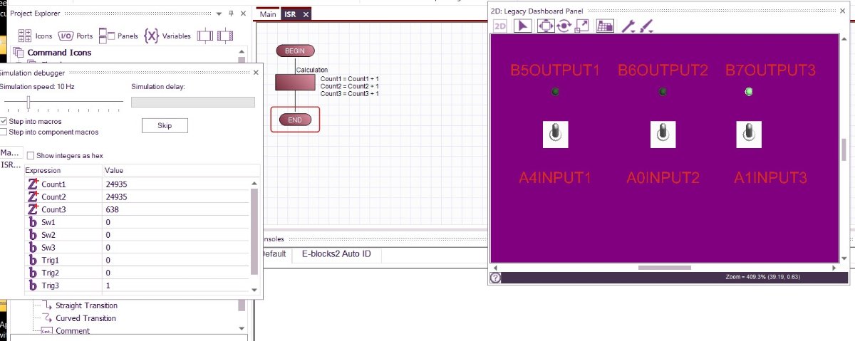

The speed of your PC can often cause confusion especially with interrupts. Running in GHz rather than the few MHz your PIC will be, things happen much faster than you expect. Hardware should be fine. Running "Fast" you will see counters increment in the thousands per second where each count of 75 equals one second in hardware...
I forgot to modify for your 10MHz crystal, now done. Note that you need to tell FC you are using a 10MHz oscillator in settings.
In the attached "On" taken a few seconds after Sw3 was activated you can see in simulation debugger that Count3 = 638 whilst the other two are 24935, and Trig3 = 1. This shows that Sw3 was detected, Count3 was indeed reset and the trigger flag set.
In "Off" you can see Count3 = 1309 whilst others are now at 25606 and Trig3 now equals zero.
Note that it has kept counting whilst I was taking snapshots which helps explain the difference in On/Off times shown versus actual times.
I've modified the chart to have latching switches as this will help in simulation. Once you see the associated counter reset you can switch off again, Run the chart at 10Hz or slower and display the variables in Simulation Debugger. At 10Hz my laptop increments the counters roughly twice per second.
Again I stress that this is just to help explain the concept of using a counter(s) in a simplistic way.
