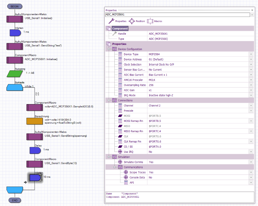

Calibriren, both ? how must one program that? :roll:
Oversambling makes problems :(
the faster you measure the less values work.
depending on the choice the measurement runs or hangs
Example every 10ms a measurement with oversampling
32 does not work
64 does not work long, sometimes up to 10 times
128 works
256 works
512 goes
1024 does not work
etc does not work

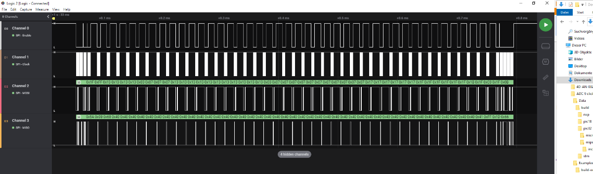

I have recorded the spi transmission.
is there a constant query whether the AD conversion is ready?
that also changes with the oversambling value
with Ov 32 I have less queries than e.g. Ov 256
does this have to be?
