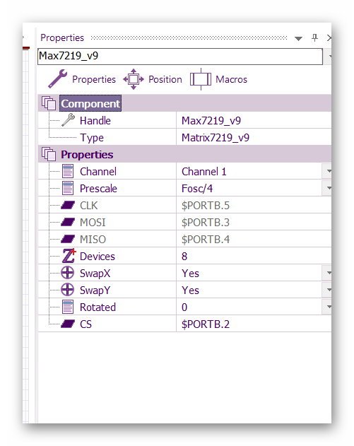

With any MCU I can not see any info on dashboard to select displays count and other parameters.
Re: MAX7219 DOT MATRIX 8 x 8 Pixels
Posted: Mon Dec 13, 2021 8:57 pm
by mnfisher
Try clicking on View -> Component Properties. You should be able to select the Max7219 component in the properties box that appears

That's the problem, I do not see anything when I open Component Properties.
Posted: Tue Dec 14, 2021 7:51 am
by mnfisher
That means the component isn't being seen by Flowcode.
Check that you downloaded the file to the correct folder.
Try adding the component to your project again - components search.

Works AOK in v10 - download the latest from viewtopic.php?p=19276#p19276
Save to a directory - and point FC at it using Build->Customize->Locations->Look for components in (might need to restart Flowcode afterwards)
