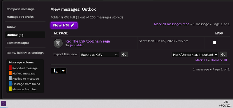

by medelec35
Hi Jan.
I replied to your PM about this at 7.46 this morning, and the message is still showing in the outbox.
PM Jan.png (104.39 KiB) Viewed 13914 times
As you have not read it, can you check that you can see the PM?
