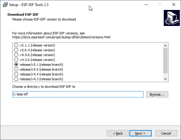

With heavy sigh I agreed to try an get the ESP toolchain on another machine.
I understand the ESP Toolchain Wiki has been updated and so I went step by step on the new desktop. Everything was as per the Wiki showed.
When setting the FC Global settings > Locations > ESP
what file/directory should this be looking for? There is no C:esp-idf as shown in the Wiki.
During set up the directory C:\esp-idf-tools was specified, this has been popoluated with all the usual files but in zipped format.
It like there is a step missing where the esp-idf unpacks and installs in the C:\ direcory?
What is the usual method of initiating this?
It looks like the ESP toolchain is still a tricky little git, ha! :)
Thanks guys. J.
Re: Installing and setting up of ESP32 toolchain
Posted: Wed Nov 08, 2023 8:14 am
by medelec35
It looks like you missed a step.
The 5th image down in the Wiki Compiler toolchain ESP32
That is also the same path entered in Global Settings > Locations Tab
Edit: For anyone reading this, we now recommend to instal idf 5.1 as idf 4.3 causes compiling issues.
