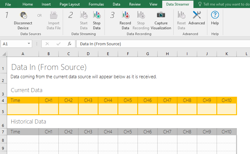

As your Terminal program captured my dummy data, it kind of proves 100% that your PC is receiving it and the issue probably lies with Excel and we should look to find out why Excel isn't seeing that before you start to send anything else.
The chart above has IntOsc set but no C-Code in Main, the WDT is enabled so will start resetting once it gets a clock and the variables have not been initialised correctly (float should be 0.0 not just 0).
I too am using 2016 with the DS add-in and I can receive my test data (and any other string).
With your Serial-USB convertor connected to your PC and running Excel DS, connect the Tx and Rx of the convertor together so that whatever is sent out on the Tx return on the Rx.
What happens when you use DS to send data?

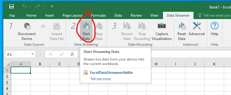

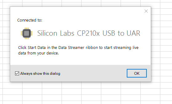

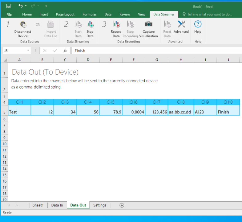

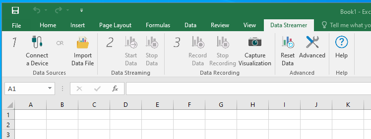

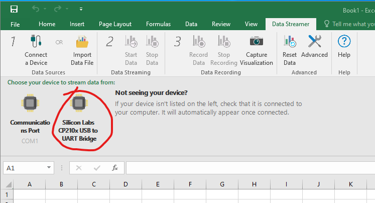

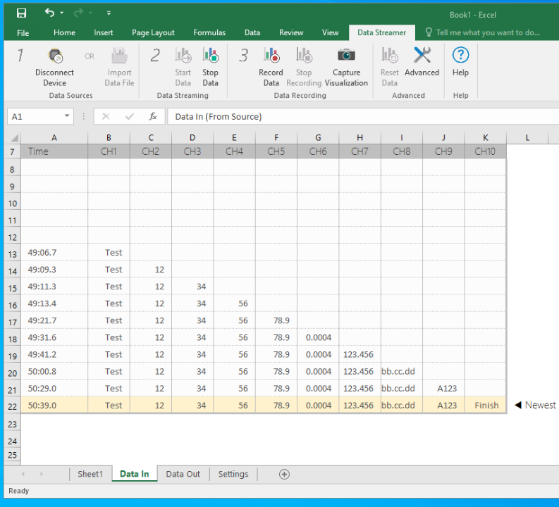

With my Serial-USB adapter connected to my PC and it's Tx/Rx ports looped. I opened up a new Excel sheet and clicked on DataStreamer in the Ribbon.
I then clicked on Connect a Device which showed me my options (and my device)
Selecting my device brings up a confirmation
Once confirmed I could then "Start Data"
This opens up the datastreamer view and at this point will capture incoming datastreams
I then navigated to the Data Out Tab and populated with data
Navigating back to the Data In Tab I could see my data.
Hope this helps.

My serial/usb adapter is Waveshare FT232 USB UART Board-Type C...
In selection "select a device", it shows "USB Serial Port (COM6)...not the type of adapter...
is there a compatibility issue ? maybe to change that with the same as yours ?
