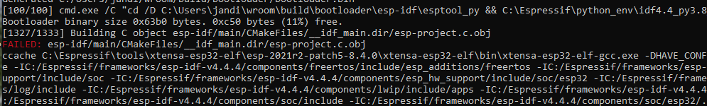

I went through an all clean install except for W10.
Whatever I try, it always fails when trying to build the bootloader. What does that say?
(I also saw a bunch of warnings that certain functions are deprecated and that newer should be used.
Should that not be cleaned up in the scripts?).
  idf.py build
[1/10] Performing build step for 'bootloader'
[1/1] cmd.exe /C "cd /D C:\Users\jandi\wroom\build\bootloader\esp-idf\esptool_py && C:\Espressif\python_env\idf5.0_py3.11_env\Scripts\python.exe C:/esp-idf/components/partition_table/check_sizes.py --offset 0x8000 bootloader 0x1000 C:/Users/jandi/wroom/build/bootloader/bootloader.bin"
Bootloader binary size 0x6710 bytes. 0x8f0 bytes (8%) free.
[2/8] Building C object esp-idf/main/CMakeFiles/__idf_main.dir/esp-project.c.obj
FAILED: esp-idf/main/CMakeFiles/__idf_main.dir/esp-project.c.obj
ccache C:\Espressif\tools\xtensa-esp32-elf\esp-2022r1-11.2.0\xtensa-esp32-elf\bin\xtensa-esp32-elf-gcc.exe -include/private -IC:/esp--IC:/esp-esp32
Jan
Re: ST7789 display
Posted: Mon May 08, 2023 9:20 pm
by mnfisher
Hi Jan,
Looks like the bootloader built okay (size 0x6710).
Is this an existing FC program or a new one? If it's an existing one - try firing up an esp cmd line (start - esp-idf 4.1 cmd or start esp-idf v5.0 cmd) then cd to your project directory (if the project is called c:\test\fred.fcfx - then you will need
cd c:\test\fred
Then do
idf.py fullclean
Then try recompiling (or
idf.py build
from the cmd prompt)
The functions that are deprecated are used by the FC libraries - and will hopefully be updated ?

Same problem Martin:
BTW Those deprecated functions are actually header files, my mistake.
