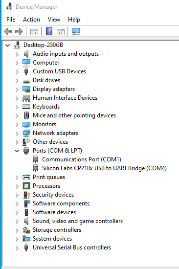

Under Device Manager I see my USB adaper under Ports.
Screenshot 2023-03-24 112445.png (33.76 KiB) Viewed 22580 times
I assume you have something similar.

yes, my adapter is in devices ( my OS is Win10 ) as FT232R USB UART , and working well at COM6...Maybe there is a problem with Office, so I'll try to test with another version , hoping to solve that..otherwise we'll have more work...
