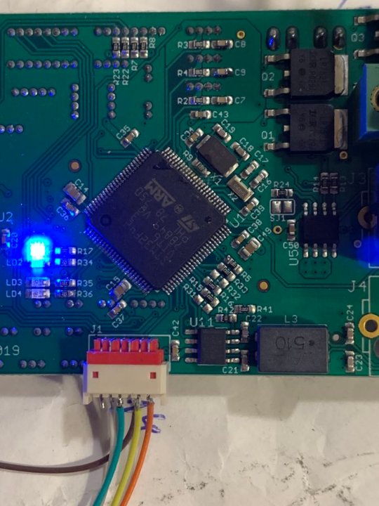

Hello
after the example "https://www.flowcode.co.uk/mmforums/vie ... hp?t=21028" I tried to convert the STM32F429ZI (144PIN) into
STM32F429VIT6 (LQFP100).
But now my target no longer works
:o
you can provide a FCDX description and this target in the library ?
Wolfgang

Posted: Mon Jan 10, 2022 7:19 pm
by knutchoco
uff
the result was initially the same: the next target no longer worked.
here the solution was the NRST to the ST-Link. Also "STM32 Cube Programme" connected again.
The last problem was SystemClock_Config to my board.
now i can program the target with flowcode
Thank you Leigh
Wolfgang
