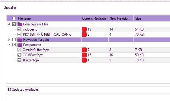

How to know which modifications are done on components ?
Before to update it's important to know clearly because some of them can be critical.
How to get the history versions and modifications
component log file.jpg (28 KiB) Viewed 14622 times

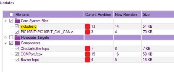

by Xbiotec
if can be implement on filename link who can open the log file will be very good.
component log file.jpg (23.77 KiB) Viewed 14608 times
click on included.c will open the log file.
Which modifications did you do on the Includes.C, CircularBuffer and COMPort ?
Re: How to know which modification are done on components?
Posted: Wed Jan 19, 2022 9:41 am
by BenR
Includes.c - Now allows for up to 3 CAN channels instead of the previous limit of 2.
CircularBuffer - GetArray was not pointing to the sim version of the function and had an unused string return variable.
COMport - Nothing to report

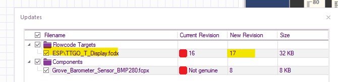

What are the modifications done on the
ttgo fcdx.jpg (18.79 KiB) Viewed 14480 times
thx
Posted: Wed Feb 02, 2022 11:05 am
by BenR
Hello Seb,
We added an experimental microsecond option for the timer interrupts.

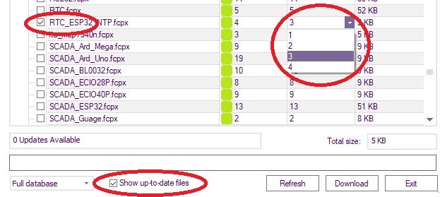

Posted: Wed Feb 09, 2022 1:45 pm
by Xbiotec
Ben, could you send me the RTC_ESP32_NTP revision 3 please.
since install version 4 , compile failed!
Posted: Wed Feb 09, 2022 1:52 pm
by LeighM
Hi Seb,
It's easy to roll back, once you know how ;)
Then click "Download"
