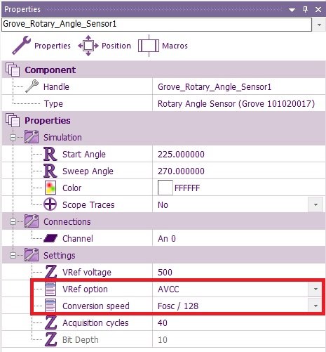

I have two things to suggest.
1 Change conversion speed from Fosc/8 to Fosc/128
2 Change Vref option to AVCC.
If VREF is the exact supply voltage or a bit lower then you should not need to use the second option.

We have looked into pre-setting the ADC configuration properties when using Arduino devices however it's not as simple as you might imagine as we are dealing with hundreds of chips not a handful of boards as with the Arduino IDE. Preloading the settings based on the device potentially has a bunch of knock on problems that would have to be very careful to circumvent. We will certainly keep exploring it and I have some ideas here on how that might be done but it's certainly not a simple fix.
For now it might be worth explaining to the students what the reference and conversion speed is and what it does as this could proove invaluable to them to a) get more resolution out of an ADC for a analogue sensor working at reduced voltage range and b) if they ever use a microcontroller outside of the Arduino enviroment they would be better equipped to understand whats going on.

I'll see if I can add some notes into this to help things along. Something like this in Appendix 1: Arduino: Section D - We recommend the following ADC settings to get the best functionality out of the ADC on the Arduino. The default settings require the use of the VREF pin and may yield more coarse samples due to the high conversion speed.
